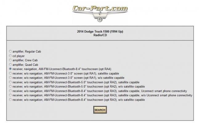

Yeah when I search for the radio on car-part the options are telematics (uconnect access), no telematics Sirius and no telematics no Sirius,
That’s why I assumed it was the telematics one.
Like SitKneelBend said, junkyards mislabel and misidentify features all the time. Ram telematics is a fleet management service provided by Verizon connect. It has no bearing on Sirius or uconnect.
I don't see them labeled as "telematics", it just says "Unconnect". Is the below what you see?
-K
I've seen it come up with telematics before.

I'm thinking if you select 2018 telematics will be an option.
-K
Do 2016.

Do 2016.
I see what you mean. That's downright weird. :/ I'm pretty certain that the one you want is the "receiver, navigation, (AM-FM-Uconnect-Bluetooth-8.4" touchscreen, opt RA4), telematics (Uconnect Access)". That should get you an "all features" RA4/VP4.
I know you don't get Uconnect in Canada and there is a separate radio for trucks sold there, And I've read that you don't get satellite radio in Hawaii, but according to the Uconnect map, there is Uconnect coverage on HI. I assumed the no XM was handled by a software setting for HI. Given the proportionately small number of vehicles sold there I don't think it would be worth it for FCA to have separate hardware for them. Not sure where the No Uconnect/No Satellite Radio units would be sold. Of course, this is all assuming that the options on the site even exist and aren't just someone's mistake.
I just pulled the list on car-part for the no telematic/no satalite radios, then ran the VIN on one of them through the build sheet web site and it came up as a US truck, shipped to Minnesota with a "3C NAV", aka RA4/VP4 radio. So, take the listings with a grain of salt (or possibly a whole shaker full).
