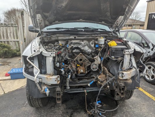

I just did this whole job on my 2015 2500 6.4. Valve job plus cam and lifters. It was triggered by a broken valve spring but along the way I found the rear-most cam lobe and lifter were pitted and starting to go.
My other suggestion, this is not required, but if you do a little extra work to take off the front radiator support frame, it makes engine access a whole lot easier. Probably not needed for a cam swap but if you are taking off the heads it makes all that stuff at the back of the motor *so* much easier to get to. You can step right into the engine bay and hug that hemi.
Basically once you have the radiator and all the coolers off, all you need to do is pop out the headlights and a few bolts, and that whole front frame comes off.
