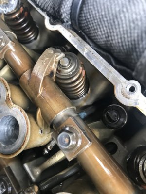

In the OP's pictures, the rocker arm assembly appears to have wire circlips that help locate the rockers in position. Mine do not have these. Should they? I just had a bent pushrod on cylinder 6 and the rocker was off to the side of the intake valve.

No, the angle of the push rod onto the rocker keeps it located against the square washer on the tube.
Slack may have let your push rod come out of the socket enough to be pushed by the socket lip and bend?
Bad lifter, cracker spring?

How many miles on the engine? If it's getting up in milege,and you happen to have revved it fairly high ,either with your foot through the floor or a high rpm downshift and the springs are getting tired you might have ran into valve float,which will unseat the pushrod from the rocker arm,then usually the push rod becomes the weak link as it'll get jammed into the side of the push rod hole or against the rocker arm and bends.Or worst case scenero,the lifter and cam went south on you,and the lifter has dropped enough to unseat the pushrod. My 14 never had the circlips either,i don't know what year they went away from them,or if Kurtis might of added them himself.He's not on here very often anymore,you can track him down on High Performance Rams or Tuned Rams on facebook usually.You're looking for Kurtis Holland on either page. I'll tell him to check in though,he's only a 10 minute drive from me.
