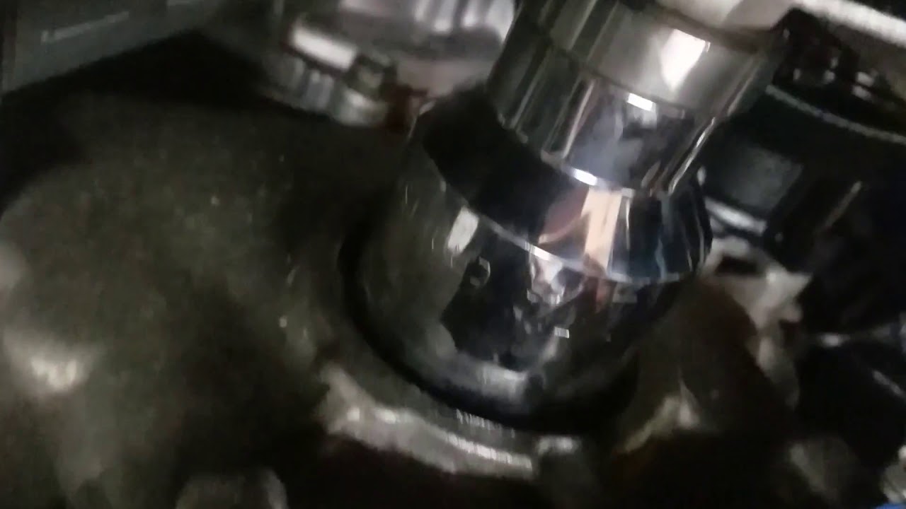

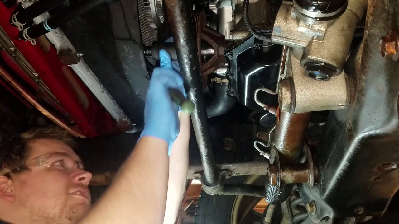

I'm in the middle of doing this job over several weekends. One thing I've noticed in all the threads I've read and all the videos I've watched, is that almost no one mentions how to remove and replace the front crank seal in the timing cover.
I did find another thread where the guy made his own tool and he said to wait to install it until after the timing cover was on, since the new seal got pushed out when he put the timing cover back on, but that doesn't make much sense to me because I think it actually seals against the balancer, and not the crank snout itself, and should therefor clear it just fine. He did say he may have been inebriated, so maybe that did it.
BUT, I still haven't seen much mention of the best way to do it. I imagine I can hamfist the old seal out easily enough with the timing cover off, but seems it's similar to installing a press fit bearing to get the new one in.
