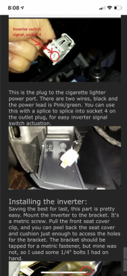

is an 8-pin connector and splice the pin number 5 to the 12v power outlet but only use the pink cable from the 12v connector and remove the 5 pin to start the 12v
The socket (dash 12v connector) does have two wires, one is a ground, one is 12v+. It's the 12v+ that you need to tap and run over to pin 5 of the 8 pin connector. I am color blind, I do not rely on anyone's color references, I check and trace all wires with a meter. Did you check the wire you tapped with a meter to make sure it is both the right one and that it has power?

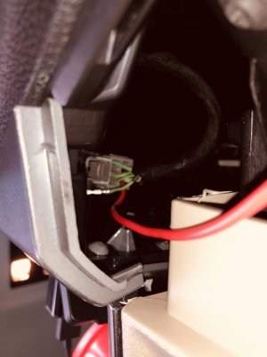

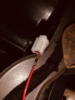

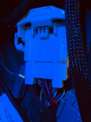

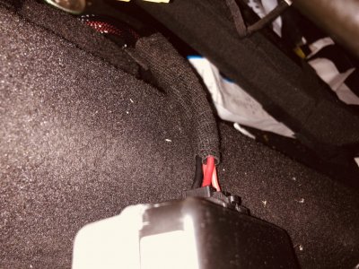

this is what I have so far kad you see something wrong in all this
kad
Jul 10, 2017
2,788
2,331
Hudson Valley, NY
5.7L HEMI
Cesar,
It's difficult to tell anything specific from the photos. One question through, in photos 2 & 3, it looks like a wire has been removed from the dash connector. To verify, that is the one from pin 5 and you've replaced it with a feed from the 12v socket?
Other than that, my suggestion would be to go over your harness and write down each connector and pin and where it goes (to what other connector and pin) and post that here. Then we can look through it and compare it with the known working ones. A second pair of eyes can sometimes spot something you've missed.

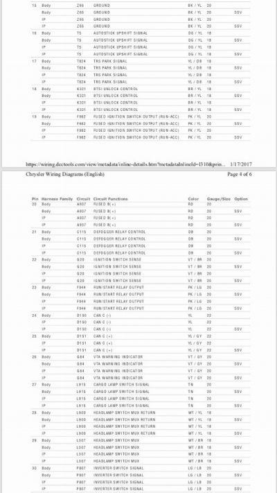

The Inverter Switch Signal wire starts at Connector C6/F, Pin 35 on the BCM under the driver's side dash and goes to the I310 connector behind the passenger kick panel where it joins the 4 wires from the I320 and all 5 go up to the dash connector.
-K
Cesar592
Nov 14, 2016
398
53
3.6 pentastar
[QUOTE = "kad, post: 2035810, miembro: 54696"] El cable de la señal del interruptor del inversor comienza en el conector C6 / F, el pin 35 en el BCM debajo del tablero del lado del conductor y va hacia el conector I310 detrás del panel de patada del pasajero, donde une los 4 cables del I320 y los 5 suben al conector del tablero.
-K [/ CITA]

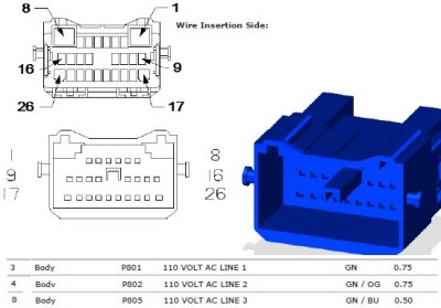

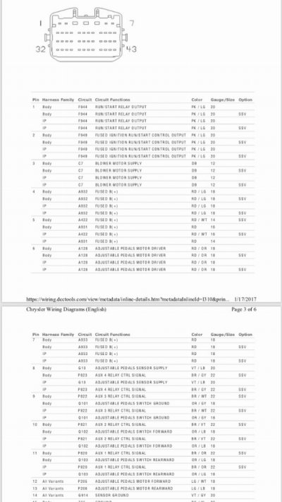

which is the i310 connector and which is the pin where it connects
Cesar592
Nov 14, 2016
398
53
3.6 pentastar
some image of how is the connector I310 kad I would appreciate it a lot I keep working on this
Cesar592
Nov 14, 2016
398
53
3.6 pentastar

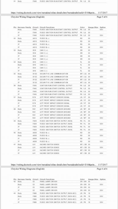

I'm a little confused my pinout is 26 pins where I connect my 3 lines of AC then in this pinout which will be the number 30 pin since it is different from the one you have your 43 pin
