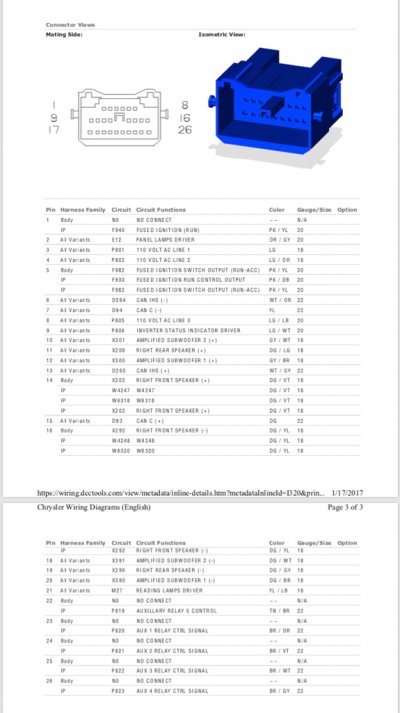

I'm a little confused my pinout is 26 pins where I connect my 3 lines of AC then in this pinout which will be the number 30 pin since it is different from the one you have your 43 pin
You asked for i310 not i320. Here is i320

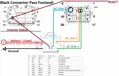

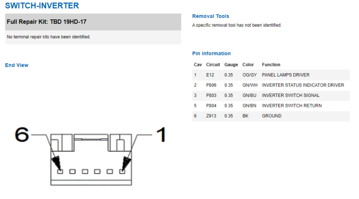

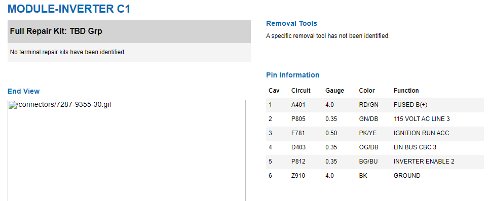

Hi all, there I see that there is a Inverter Status Indicator Driver pin on the INverter. Where does this pin out? I also see there is a Inverter Switch Signal on the Black Connector in the passenger footwell, AND at the plug iteself in the dash.
I then also see there is a Inverter Switch Signal on the BCM.
I have a 2014 Tradesman, so I am doing most of the wiring from scratch. I drew up the below, but am unsure about what to do about the Inverter Status Indicatior Driver on the inverter, and the Inverter Switch Signals on the black plug, and the BCM. Thanks for any assistance... upload_2020-5-13_17-18-55.png
Rght, the inverter status just sends back to BCM that it's working. You would only need this if you are enabling the inverter through the BCM. BCM may throw a fault code, or shut off the outlet without that signal.
