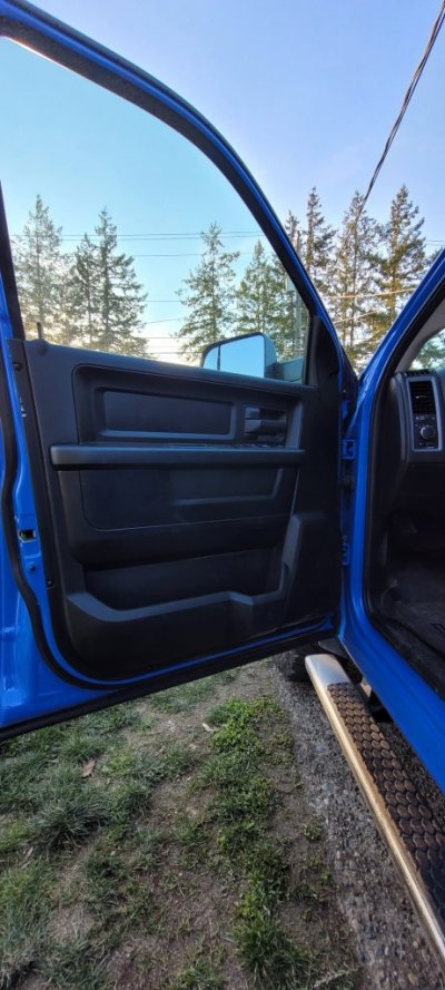

I actually tried to use an handheld steam cleaner. even with fine tip it didn't attack all the grime like I thought it would. I ended up going with Dawn Powerwash. used about 1/3 of a bottle on each panel. Sprayed top to bottom, let sit for about 10min, scrubbed with soft sponge, rinsed, scrubbed some more. Used a toothbrush on the corners, seams, and the speaker mesh.
I only had 3 hours to work with with the after noon sun and wanted to get them done today as it will start to rain again tomorrow.
I might double check them again when weather gets nicer again.
