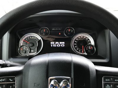

I have the 7" EVIC Premium Cluster installed in my 17 Ram everything works fine just want to know how to change the popup screen that currently says "power wagon" every time I start the truck. How do I get it to say "sport" or "ram 1500" instead?

Go take a look in the alpha OBD thread. You'll have to purchase the app on the Google Play Store + buy a Bluetooth OBD connector but you can actually go in and change what you want the screen to say with the tool. I am assuming since your truck does not have anything specific identified for the screen to say in the BCM it's showing the default of what the screen had before which was Power Wagon.

I thought that what I would have to do. Thanks for the info sir.
