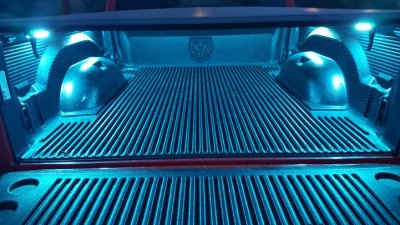

So I put on a Lund Tonneau Cover about a month ago and I found it near impossible to see under it at night, and even during a bright sunny day I couldn't see up front by the cab.

Step 1: Testing & Mounting LED Bars
Take all of your LED strips and test them to make sure they work before you do all this work and they end up being defective. If you bought the same exact Pilot Automotive LED Bars that are listed above, they have a battery pack inside to test one of the light bars on store shelves. Simply cut the wires off, strip an inch or so, and now you have a battery tester for each led strip. Just connect the wires from the battery box to the wires on the LED Bars and you will see if they work properly.
Next, decide where you want the led strips to be placed. Then take the 3M double sided tape that came with the LED's and apply it to the back of the led bar. Then mount them and make sure to apply lots of pressure so they stick nice and good. Do this to all 4 (or 2 if you only bought 2).

Now test your bed lights!!! If they work, congratulations!! Now go back to your bed, you can finally push your switch into the hole because it will be in their for good now and make sure it's nice and tight. If for some reason it's loose, add some RTV silicone around the inside lip of the switch so it seals.
