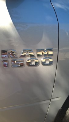

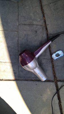

Hey Everyone, I just did some cosmetic changes to my truck, took off the Flex Fuel SLT and the 1500 off both doors, and dipped. I am going to try and do a write up on how to do it the best way (for me atleast). The tools i used was 1 cap of Plasti-Dip, Hair dryer, cooking stone scraper, Painters tape, Dip-Disolver, Microfiber, Tooth pic, and Patients. There are many methods out there to debadge and dip, but this is what i did.
Here is a link if you wish to buy dip dissolve, i am using a ebay knock off that work just fine, but here is the real stuff
https://www.dipyourcar.com/Dip-Diss...mQygw6_uLJxwF0WxY1bMvXnHgfwPcPBUSuhoCOTLw_wcB

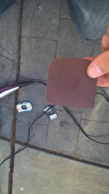

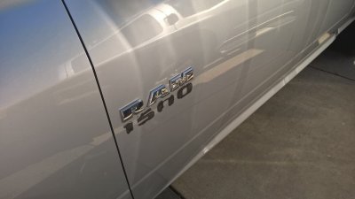

What im starting with

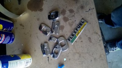

I used a cooking stone scrapper, really gentel and plastic, to help pry up on emblems when blowing so you dont cook your fingers, there a dime a dozen. DO NOT USE ANY METAL, i have seen people you flat edge blade or box cutters, unless your a ninja at those, you'll **** it up.
Everything Removed
This is what i removed from the door, Just removed the 1500, Depends on how much you heat it or how you pull the emblem off. There will be residue. I used my stone scraper to remove the gray 3m tape off. But to remove the adhesive from the door. I used my Dip Dissolver (which smells like and acts like goo gone.... Could be different, the dissolver is 100% safe on paint) to remove the adheasive, took some elbow grease but be patient it will come off. I worked at little sections at a time not the entire part.
This process will work for any badges you plan to take off.

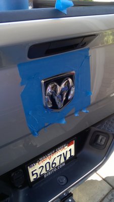

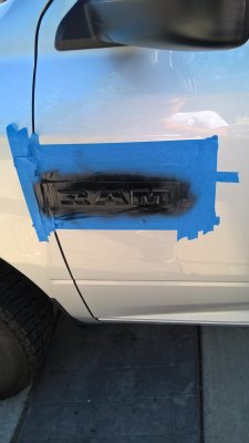

Time to mask everything down
I would recommend if you do not have Dip Disolver or some sort of solvent, mask with towels, paper , or plastic wrap because dip has alot of over spray.
Once you mask it, With the dip for easy removal, Spray from tape side to tape side. You will think your done after about 2 coats, but for the ease of removal do about 5-8 coats, doesnt take much longer. TRUST ME its easier. Make sure the first 2 coats are semi light and do sprits not a long spray. Dip likes to accumulate at the bottom of each letter, so allow some time before spraying, i do a coat every 4-5 min, if your doing entire truck just make rounds.
When Removing the dip the tape will help you remove the dip on the paint. Aswell when remove the interletter dip, USE A TOOTH PICK, do not use a flat head screw driver... With enough coats little effort will be needed to remove it

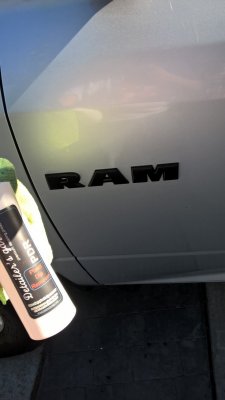

Once done removeing tape and dip from letters, wipe down any over spray, I used dip desolver and worked wonders. If you do not remove overspray the dip will cure and be hard as hell to remove at a later time.

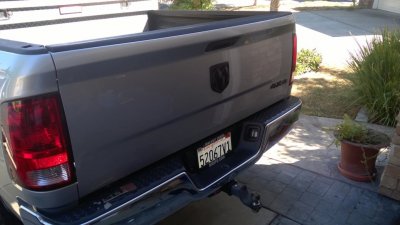

Finished product
This took me about 1 1/2 hour todo the entire thing, Fairly safe job todo your self, the most risky thing is the removal of the emblems, just dont keep to much heat on it, just enough to loosen the adhesive.

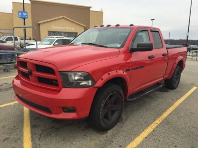

Nice step by step! I dipped my emblems and wheels last year and love em!
