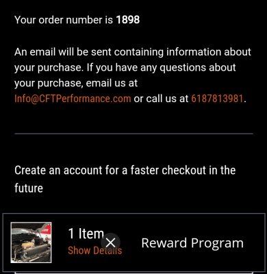

I ordered one today. Didn't want to reinstate my Facebook but, I think it was worth it. Should be here in a few days.

I just installed the CFT delete kit. Its just a screw, spacer nut, and lock nut that installs in the same spot alot of people put screws in. It also comes with a spacer and bolt to mount at the top of the core support where one of the factory 13mm bolts was holding the AGS in. Hopefully it works out, but for $5 I won't be to upset if it doesn't.
