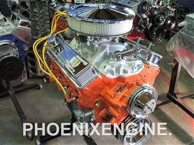

A short block, at least as I know it, is the basic engine like the block and the pistons, whereas a long block includes additional parts like the camshaft and valve covers.

Short block = Block, crank. rods, pistons
Long block = Short block plus: cam, timing gears / chain, heads, pushrods, lifters, rockers. (some include tin like oil pan and timing cover and some come complete w/ water pump, oil pump and such)
