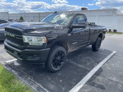

Thought I’d share a few photos of my ride with the “new” 20” wheels on it. Just a bit bigger and they fill out the wheel wells so much better than the 17’s. Not sure, but I think I read that the 20” wheels were from a “Night Edition” option on a higher trim level?
