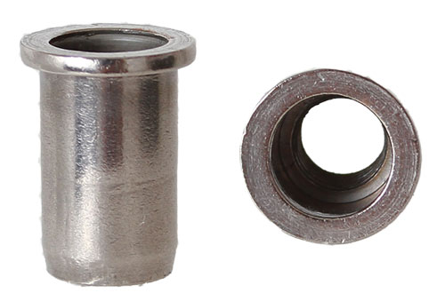

So color me confused. Why hassle with rivnuts? I see where one of the posters used a drill where the rivnuts go so I would presume there is some kind of clearance behind to let a drill bit go through. If so, why not use regular nuts and bolts where the rivnuts go? No wrench room maybe? And yes, I'm still waiting to get the skid plates on backorder too. Got the front one OK and it went on very easily too. And I love the original post with pictures---that is something I can understand, thanks. :winner_first_h4h:
The rivnuts go into the frame in existing hexagonal holes and are going into hollow frame members, there is no way to get a nut inside that I am aware of.

3) Power Steering - this one requires rivnuts to install it but Mopar offers a little tool to help you install them. This is offered as a 'kit' on some sites but I chose to buy separately because again, it saves money. You'll need 4 rivnuts and 4 bolts.

The pack of Rivnuts you see in the photo are not the ones I ended up using so I would suggest just getting the Mopar ones

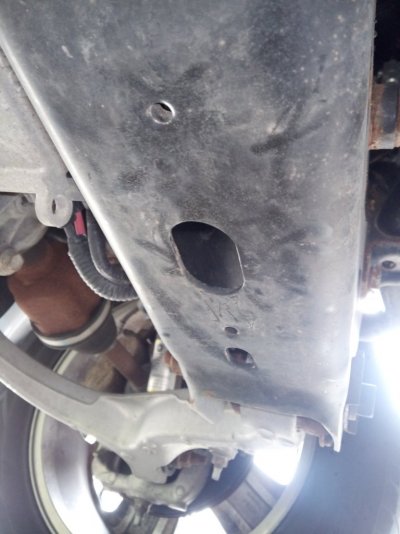

So for front axle, on one side there is wholes with threads but on other side( closer to bumper) there is no threads, and I checked all wholes. So how did you manage to bolt screws for front axle skid plate?

As you can see on my photos no threads indide
That's what the Rivnuts are for.
I was thinking the same thing. The bolts are sold as self tapping bolts in their description. So those ones dont require anything but the plate and 4 bolts.
