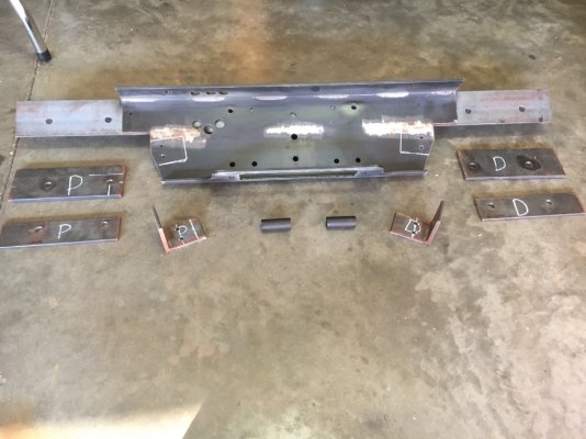

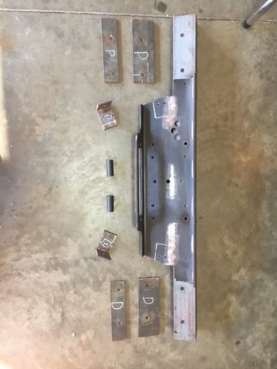

This is everything you get with a raw mount. The tubes come raw, not black.

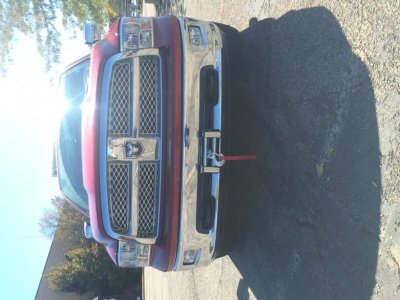

Y'all have inspired me. I used a 12,000 pound winch. I primed and painted it black, it looks great I think. 4aaf610e851b8d7aaa26ab0ea3e5fa85.jpg9954f7fa1b5834e36d9797fdebcc5b54.jpg

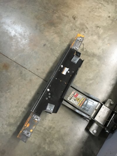

This is basically how I did mine. Lots of measuring and tack welding.
Only the side plates are tacked on. The plate itself has 3" welds every 3". That was just my first plate. The new ones I'm making are a lot cleaner now that I have it figured out. 73b5eb24d3cc4998afac83e955efe2bb.jpg

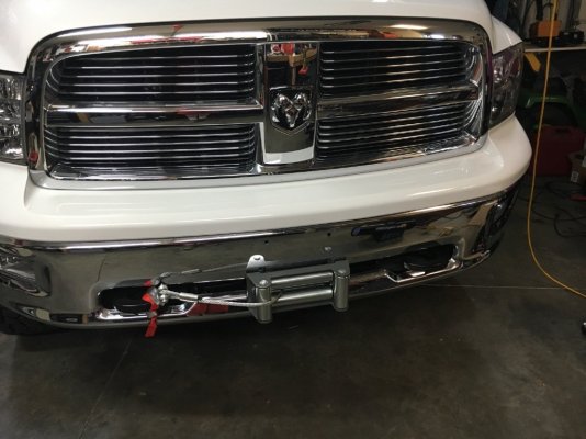

2009
my 2009 winch installed
I won a 12000lb winch at an auction and was going to resell it but was so inspired by your posts I thought I would give it a try.
Thanks for all the tips.
