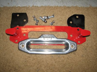

Looks really good and clean.
What is that "red" part called?
Does it come with the winch?

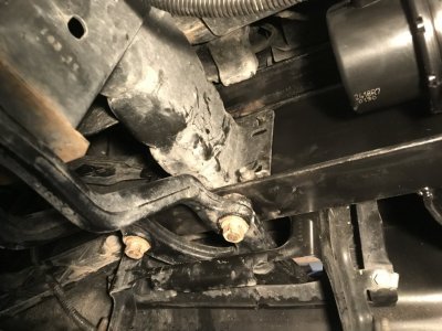

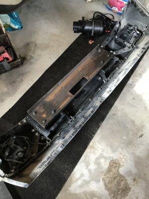

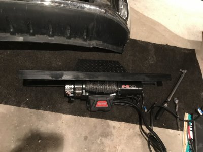

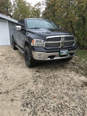

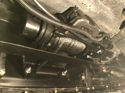

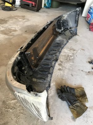

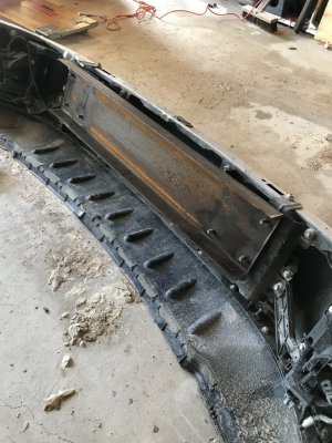

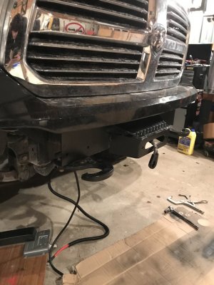

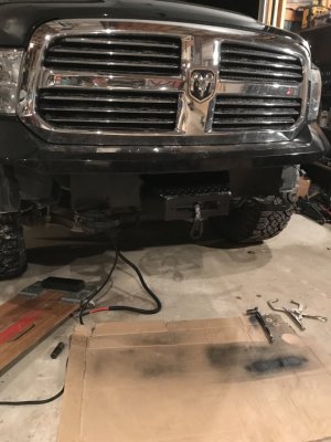

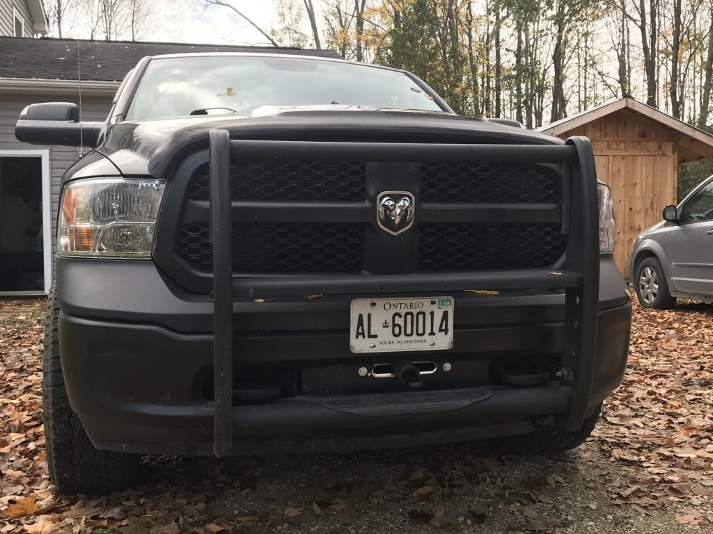

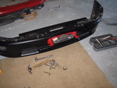

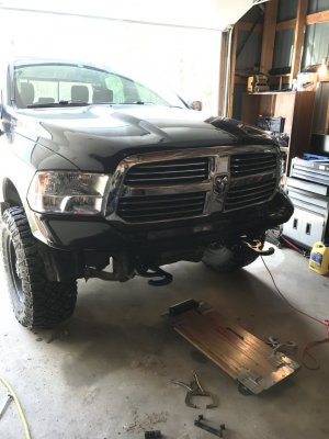

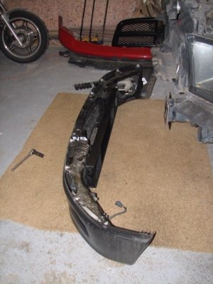

Hey guys. I'm new to this forum. I just installed a winch behind my 2015 ram 1500 bighorn bumper. Got the idea from a ram rebel winch mount on YouTube. Thought I'd share some pics
Does this alter the way the bumper sits at all? I imagine it pushes it forward by 1/4 inch or so.
Curious to know what materials you used and how you cut the bumper. Ive wanted to do this for a long time, 1st one ive seen on a ‘13+ and a chrome bumper. Your setup is pretty much exactly what im looking for.
It does push the bumper forward a little. You can see it from the side where the bumper meets the fender. Other than that it's still under that plastic upper bumper piece.

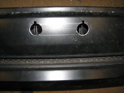

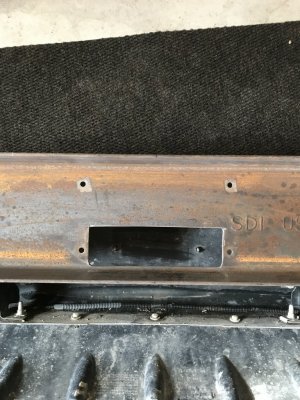

Nice job BTW.

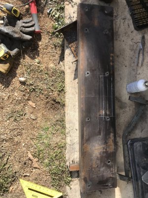

Thanks! I used a 8" channel and 4"X 1/4" flat bar to extend the fairlead mount. I wouldn't trust the stock bumper to just bolt the fairlead to. To cut the bumper I used a 1-1/2" hole saw to drill 2 holes, then just cut between them with a cutting wheel, then sanded the edges smooth. 1-1/2 is more than enough so my winch line will never touch it. Probably could've got away with 1-1/4" but oh well. Haven't tested it out yet but it's tied into the 6 frame rail bolts and the 4 tow hook bolts. I don't think itll go anywhere.
Do you happen to have a picture of what that looks like?
