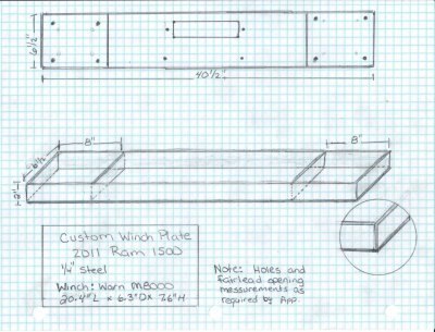

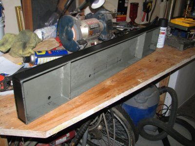

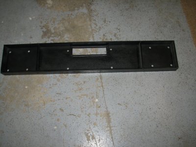

To all those interested in doing their own hidden winch, I see that many wanted Dantheman to make a winch plate and ship it. However, since nobody has heard from him in a while, I will share with you my winch plate design. Look back towards the beginning of this thread and see my build. I have lots more pictures that I can and will post to help guide you if you would like to replicate my design. Could I make you a winch plate too? Yes I could, but I won't. The expense of manufacturing and shipping would make it cost prohibitive for me and you. Instead, here is my design. Take this to a local fabricator and have them make it for you. It will be cheaper than me making it and shipping. You should be able to find someone in your area to build this for $250, give or take.
Note: I have deliberately omitted specific measurements for bolt holes and fairlead opening as these will vary from build-to-build. Winch Plate Design.jpg IMG_3034.JPG IMG_3139.JPG
Hope this helps get you started. It's a very different design than dantheman but it works. It sits higher on the bumper too! A look that I really like.
Keep fabricating Ram enthusiasts!
