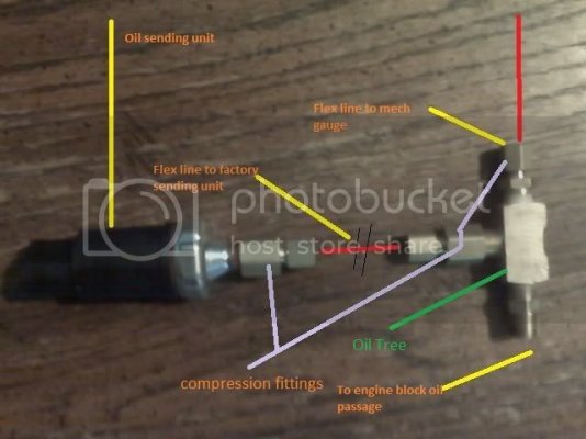

All fittings are 1/8 NPTF, three compression fittings are needed.
Thread tape is not to be used on the fittings, use a small dab of pipe dope or thread sealant.
Flexline kit and fittings, these parts should come with a gauge kit.
There are many ways to make up the oil tree but these are the parts I had around.

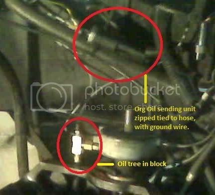

Clean the area as best you can around the org sending unit, remove the org sending unit with the sending unit socket. Install the oil tree in it’s place and start to run the flex oil line. The line uses compression fittings do not over tighten them, just snug and 1/16 turn.
In this photo (below) you can see the oil tree installed and the org oil sending unit zip tied to the heater hose. For those with the org keg style intake you will be almost working blind.
The org sending unit needs a ground wire, I just used a small hose clamp to hold the wire to the sending unit; then find a good spot to ground the wire to.

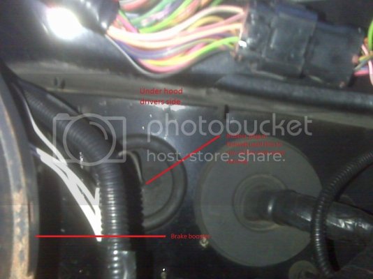

This is under the hood driver’s side, I used a small punch to make a hole in the rubber grommet, and then feed the oil line and wires through it.

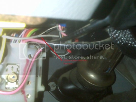

This is under the dash, oil line running under dash and up into the fuse box area.

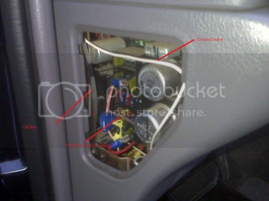

This is the fuse box; you can see the oil line going up and through it. This was done just for the photo, I moved the oil line out of the fuse panel after the photo was taken.

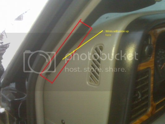

This is where the oil line and any other wiring will come up through; it is then routed up and into the gauge pod.
I used the Accel 2650-1157-00 dual gauge pod it is a cover not a complete a pillar, there is supposed to be a spot to run wires and lines between the two pieces; it does not work, I had to cut the org pillar (holes right behind the pods) so I could run the wires through it and behind.
