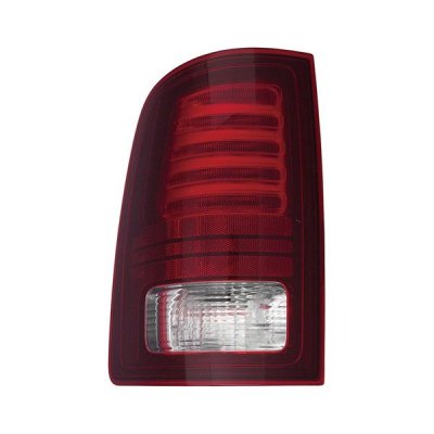

Interesting ... I had the same issue with my truck, same taillight too. Do you have the factory LED tails?
Dealer said that "one of the LEDs was out" in my taillight and they replaced the LED. I'm not sure how they replaced one LED, but they assured me it was a single LED which cost $8 CAD (which they waived).

I will pull the bulbs tomorrow. The dealer I bought the truck from replaced the bulb. I don’t think they are led. Do oem tailights have led bulbs? 2016 Bighorn.
I will say this. I started the truck today and it said no stored messages. But within a few seconds it came back on.
