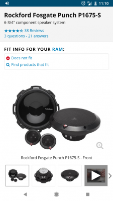

These are the speakers, tweeters would go on the dash 6 and 1/2 half would go in the doors.
