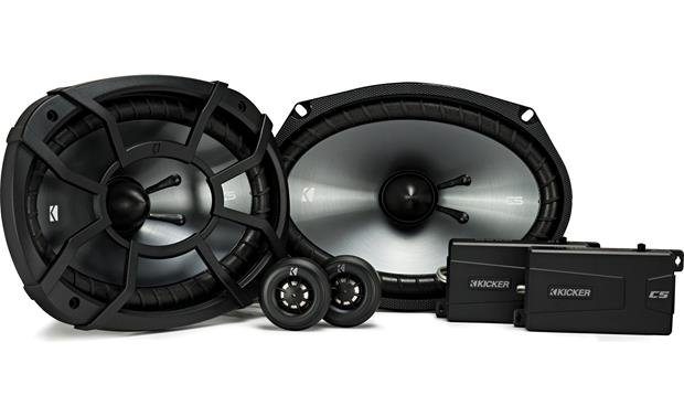

For 6x9's in Ram doors, the list is actually pretty small when it comes to what will fit and what will not. Many members have had to send back various 6x9's due to depth issues, basket clearance issues, excursion issues etc...
Alpine type S
various JBL
some pioneer
some Infinity
some Kicker
some others.
Image Dynamic's monster xs69's will not fit. I've purchased them HOPING TO GOD they would fit....but they wont
adding too much spacer will cause excursion issues, OR the mounting plate will hit the inner concave of the factory door panel
Don't get me wrong, I'll cut up a door and make anything "fit"...but most members are not willing to pull out those types of tools lol

Kicker DS and CS may fit, regular cab, versus CC and QC. The Kicker QSC69 will, as it has neo magnets and a true point source....but $400 a pair too <eek>
