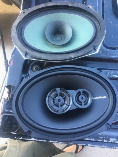

I did just put these fosgate 6x9s in my black reg cab, and ill say this, IMO they are much more clear then my kickers are, when i was testing them i had a neighbor come from across the street and tell me he could make out every note perfectly that far away, so if you want to stray away from kicker then id give fosgate a try
Also the CS speaker line is pretty much their base line of speakers, not knocking them because thats whats in my red 08, but if you are going to play it hard and loud, then you may step up to the higher end series of kicker, if you go back with them

I went with 3 way 6x9s in the doors and added tweeters to the factory dash locations (actually replaced the stock 3.5’s with these tweeters). This way you’re basically building your own component system. I did this for two reasons:
1. I hate cutting unnecessary holes into the interior for stuff like speakers. I like to keep everything as stock looking and reversible as possible. So the tweeters went up in the dash.
2. You can have full range sound coming out of the 6x9 without negatively affecting its low range capability because (at least with the kappas I have) the mid and high frequencies are made by separate tweeters which you can fine tune to your liking. The kappas actually have a button on them that you can push that will reduce the decibel level of the high range, before you even need to adjust them at the radio or amp.
