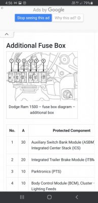

I saw additional fusr box on the web, but not sure about location.
Attached photo

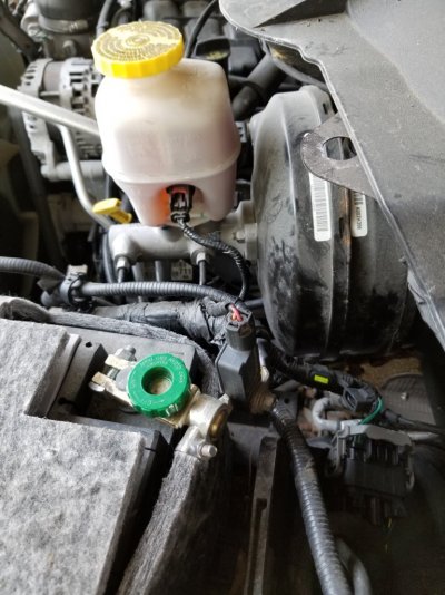

There is a single inline mini fuse all by itself on a small harness pretty much right beside the brake booster.
Follow the wires leading from the negative battery post about 6 to 8 inches. It is under a flip up cap and is yellow.
When a mechanic pulled that fuse to shut down my failed update radio I lost my a/c as well.
It is the yellow line in this pic

i found this on other search the fuse is ok and for me, it powers the display only
so if you remove it the display will turn off
so now im on the process to by new switch panel and/or the A/C module that is in the dash at passenger side door
