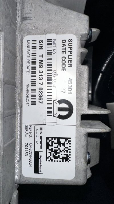

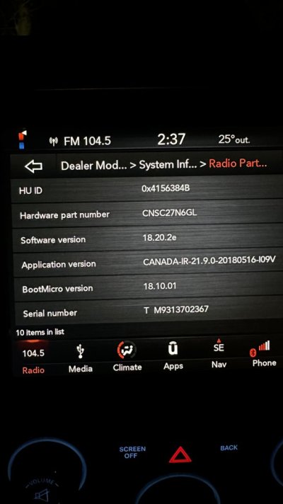

Hi guys,
I read all 19 pages of this thread. My issue started when I wanted to get CarPlay. My truck is 2013 RAM 1500 Big Horn with 8.4” Uconnect and single zone MTC ( with SXM) I’m in Canada btw.
I got a hold of used 2018 radio with NAv out of 2018 RAM ( Panasonic).
I connected the radio and I saw dual temp slider on the screen but I knew I had to leave it for a while for BCM to sync with the radio. Next day it reverted back to my single zone and all was well except the temp control issue like everyone else on this forum. I picked up used hvac module 552A but this didn’t fix anything. I tried to set to BCM to dual zone auto and then single zone and so no results ( I might repeat steps again just to confirm I’m doing things right) but that didn’t fix anything. Today I read this thread and there is hope for me to get back controls by converting to single zone ATC so,
I picked up temp sensor and humidity sensor out of 2019 RAM 1500. Just waiting for m2mods to email me back with what I need to get it working. ( I wonder if harness was run to any sensors).
On a separate note, like someone mentioned here, my temp on radio is stuck in Fahrenheit while on Evic is in Celsius and everything else is metric.
Thank you Mpgrimm2 and others for diagnosis and coming up with solution to this problem.

Hi guys,
