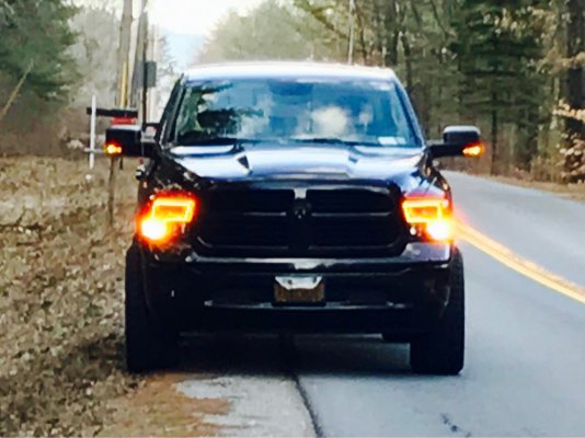

I had to wire my resistors in with both end of resistor wired into the ground wire of harness. However mine is a 2015 but give it a shot . Works perfect now ea3b48675fe1a8ba6a869ad0cf542cca.jpg

Wow that's really weird but I guess it's worth a shot, but it makes no sense that it only sometimes hyper flashes
