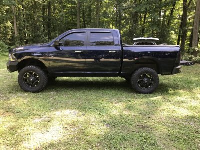

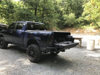

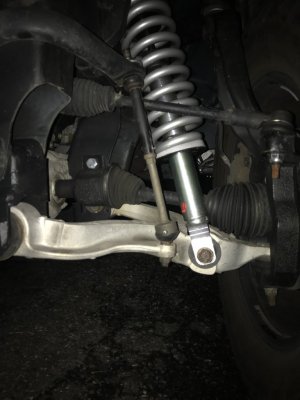

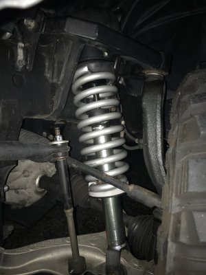

F172F17A-7D21-4FEF-BCB1-E5AB4A2CE106.jpeg 1913A9B2-56F6-4B67-B507-C0550FF4C8C5.jpeg C6F19EF3-BAC0-487A-B41F-AFC33AD0217D.jpeg D2526D67-72CC-44C6-8ED8-546CDE79BC09.jpeg So in an exhausting extensive research extravaganza I decided that I would be the guinnepig and try this new set up out. If you noticed any of my other posts I had quick struts on my 2012 1500 4x4 that I purchased used so I can not compare to a stock ride. The eibach coils are absolutely amazing and I will continue to post as my build is still a work in progress. Currently I am 1” nose high so I am researching what I should do in the rear. (Leaning toward 1.5” rear coil spacer) I do like how JB1 did the procomp brackets on his BDS lift and I may copy that idea before I add a spacer to the rear.
The settings I went with on my eibach struts was the 2nd groove with the eibach spring they are calling that 3.5” the lowest setting is 2.75”

Damn 3.5” lift?... it sure looks tall
I’m glad someone took a leap of faith and tried these out, they look great. Any issues getting aligned?

I haven’t gone for alignment yet. So I can’t answer that yet. I have room in the slots on both sides of the lower control arm bolts so I don’t anticipate any issues. I don’t have jack stands tall enough to drop the rear to install rear coil spacers so I planned on doing the alaignment the day I go use a lift. Did you happen to measure before and after when you swapped the bds bracket to the procomp? Just curious

The procomp rear control arm bracket doesn’t give any lift, it just corrects the control arm angles and eliminates axle wrap. The rear box kit did include the procomp lower coil spacers but those are 4.5” of lift. I didn’t use any of that

Thank you. I figured there was no diffence but can’t hurt to ask. I’m thinking of the 1.5” or the 2” rear coil spacer as the rear is exactly 1” low right now. but looks a lot lower and has a mini Cali lean or pro runner look to it.

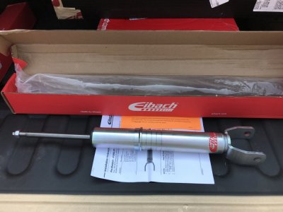

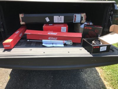

I talked with the eibach rep on the phone for a good 45 minutes drilling questions. I have had great experiences with their coils in the past and I was confident they would provide a great spring. Their approach to the shocks/struts is if you want it built right build it yourself. They also offer the million mile warranty so that swayed my decision. I had Bilsteins on my ford Excursion and wanted to play the field a little more. With everyone running them on this forum I know with certainty I can always grab a pair and know they’ll work.
The rep did tell me the fronts come assembled in the kit but they don’t assemble when you just order the parts. I ended up ordering from car id and their rep assured me the lower spring cup came with it as pictued. They did not as I suspected because the eibach directions state re use factory. But my plan was to assemble them prior to installing

So the truck has a 6” lift and Eibachs set at 3.5” additional lift?
I like how high the front sits and I’m looking forward to final pics after the back comes up more to get rid of some of the squat. What size are the tires in the above pictures?

20” wheel 35” tire. They did shrink quite a bit with the lift

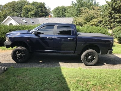

4F885C83-952C-4AA1-B4FF-726C1E5E4678.jpeg 7FA14596-D57B-44EB-B3F6-6AA01952733C.jpeg 3D059B4B-3D6E-400F-AF8D-45EFE8734F50.jpeg 90F0230D-3F4F-4F65-90D3-FDDF2DE4044A.jpegHere are some angles before the eibach these are the quick struts with the zone lift.

It looks good. I like it and it’s making me consider getting the Eibachs
How are the CV angles and upper arm angles with them at 3.5”?
First post I have my cv and uca angles. I will get some better ones today

Not quite but close, Zone and bds are only 6” kits when you use the preload spacer, without that preload it’s closer to a 5” lift kit. But yes he has an 8” plus kit now lol
does anyone make a 2.5” rear lift spring? Would I have t change the rear shocks if so? Decisions decisions.
The shocks are the key, might have to look and see what rear shock full throttle uses
Skyjacker makes a rear coil, they use it in their Ram 4” kit
