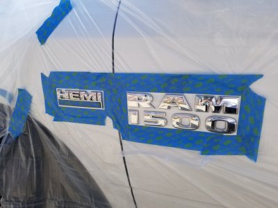

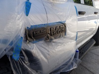

Ok so I'm sure mostly everyone here has used it in the past. I've used it over the past 5 years for minimal items such as badges and trims. For me, it's a hate/love thing.
I'll never be perfect at it, but after frustration for a couple hours, it usually ends up in the category of "good enough" for me lol.
Here are some prep pics, and finished products.
For anyone wondering about the "5.7 Liter" badge, in order to keep that visible while leaving the border blacked out. I used blue tape to cover the lettering. Before the last spray gently peel up from one corner so you can grab it easily. On the last spray while it's still wet you have like 5 seconds or less to grab the corner and peel it without it ruining the rest or pulling anything else up. Is it perfect? Heck no. But it's all I could think of and I wasn't taking a blade to it.
To be honest I screwed up the first side because I took too long to peel. The 2nd side is when i figured to lift a corner prior to the spray and then grab and pull immediately after the last spray.

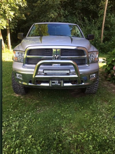

It’s a love/hate here as well. About two years ago, I used plasti-dip for hood stripes.
There is definitely a learning curve to when to pull the tape off.
Like the OP, they came out “good enough for me”.
On the plus side, if I decide to change/remove them, I can just peel it off.

That looks good from here! I can't imagine using dip to perfect those lines...I know id screw it up lol .... but for stripes and random designs I tend to use vinyl and knifeless tape.
