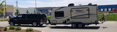

Thank you. I am using the husky round bar weight distribution hitch. My trailer Maxes out at 5800lbs. I have the hemi but the rear end is only 3:21. You can see the little sag in this pic or it is the parking lot I am not sure. We have towed this trailer about 8000 km last year and if my wife has her way more this year
