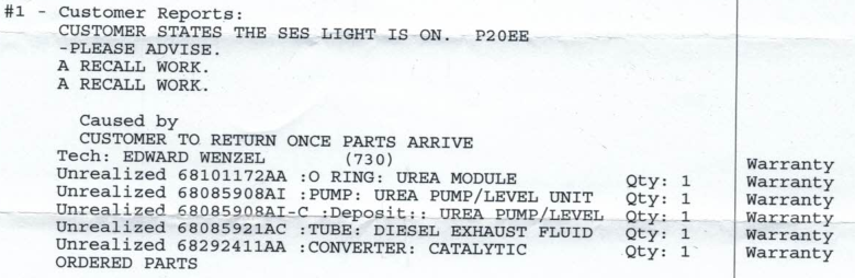

My dealer completed the diagnostic, and I picked up my truck while they wait for the parts to come in. They are replacing all DEF components, excluding the DEF tank, as well as the catalytic converter. My service writer assured me there would be no out of pocket expenses, everything, sensors included, are covered by the 67A recall warranty.
I've read posts from others batteling the P20EE code and had simular repairs. The DEF replacement only solve the issue for a short period of time. I've yet to read a post that claimed the P20EE issue was solved which is scaring me.

I've been patiently waiting for the parts to come in, but it looks like that may never happen. The dealer has no idea when they will receive the parts they ordered (or if that will fix the issue). While the warranty for 67A is all-inclusive, it is worthless if they can't get the parts.
Here I am at the end of June, with camping plans put on hold (and a mad wife), and my ability to move around my equipment to boost retirement income is also on hold. So I am seriously considering deleting the emissions system. I do not see another route out of this mess. I've asked the dealer to restore my truck to pre-67A, but they won't or can't, wasn't sure which.

No idea what parts you are having to wait on . Making a guess here , I'm thinking the recall may have created the shortage here ??
I listed the work order and the Mopar part numbers in post 10. It is interesting that if you search for any of the Mopar part numbers, the parts are available on many sites. Apparently, the parts are not available to dealers. From my perspective, making parts unavailable, particulay the parts need to fix the 67A screw up, is a method used to discourage folks like me from keeping what I have and replacing. I have a feeling the lack of parts is purposeful because they know the fix isn't a blast of the parts cannon, so why invest the money in warranty parts when they know the outcome? They may have chosen to sit on it and let time cure the problem.
