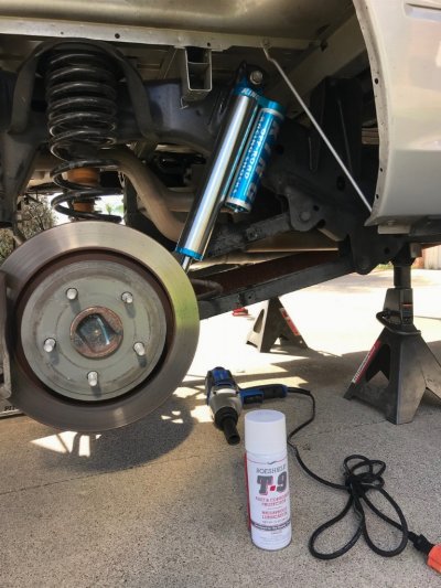

Lift the truck from the diff pumpking then place the jacks in the frame behind the LCA's mount.
46425518382_5a4321f9ae_h.jpgUntitled by RAM RSM, on Flickr
46476457801_27bfc64e82_h.jpgUntitled by RAM RSM, on Flickr
2 jacks and 2 extra stands will come handy if you don't have anything to compress them as you'll want to disconnect the trackbar from the axel to give you enough room to fit them in.
