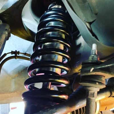

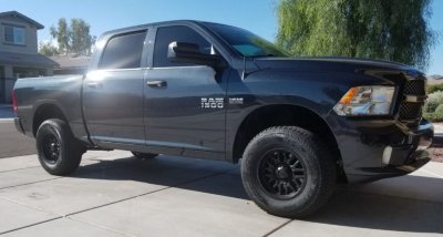

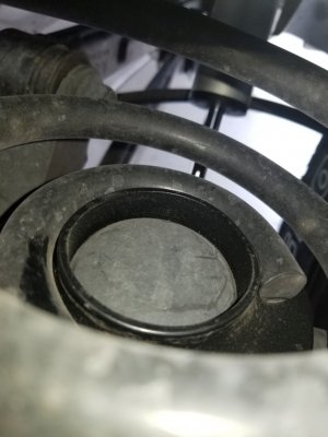

So, I ended up with ICON coil overs up front. Shop set them at 2.5" which is preset by ICON. Rears I put ICON shocks as well. I already had the TTC1210s rear coils. My memory says I got 1" lift from them (forget). I also added the 3/4" TGC spacer. I'm happy with outcome. It sits on 285/70-17 Yokohama's. If anyone was wonder the look of the setup. First pic is completed setup. Second pic is TTC coils and spacer installed. Third and fourth are shocks.

Been considering these ttc coils and a spacer like you're running. How do you like em? Both my bilstein and superlift coils are too soft for using this like a truck.

Thank you!
I'm picky. Hence why I took off the Bilstein 5100s. I am very happy with this setup.
I was worried about superlift coils being to soft. I have used TTC coils on 2 Rams so far.
Owned jeeps and been going offroad since the 70s. Great hobby!

Looks great and I'm sure it rides even better. Would you mind taking some measurements? I'd love to know the ground to to of fender well numbers and top of tire to fender well distance. I'm trying to find something to replace my spacer lift and can't decide between something like this or a full 4" kit

Ill get it this weekend. Thanks

I'm trying to find 3/4" spacers to go with eibach 1" rear coil and springs. Do you have a link for 3/4" TGC spacer?
don't know what tgc is.
crazykid1994
Sep 21, 2013
5,063
5,064
Florida
Top gun customz. I actually have a set I think sitting in my storage. Used but good condition. Can’t remember if they are 1/2 or 3/4
