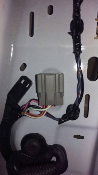

Here's the I440 connector, on a crew(likely quad as well) cab it's in the pillar just above the seat belt on the rear passenger side. Very easy to get to. And I verified it's got the Lin bus and run relay wires. So would just have to populate the other side of the connector.
Sent from my HTC One M9 using Tapatalk
