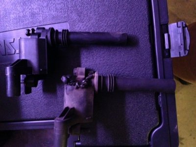

okay my trucks been taking longer to fire the last couple of days well today the engine light came on
the code i got was p2314 ignition coil "e" secondary circuit
i was told needed a new ignition coil a little checking online found out the was #5 so bought a new one replaced it started my truck fired right away but the engine light was still on so i turned it off and disconnect the neg battery cable to reset everything but the cable back on now my truck wont fire?????
any suggestions i thought i did everything right but did i mess up in my methods here?? here is a pic of the new one and old one

man i appreciate that a whole lot!
feathered the throttle it fired and when i let off it acted like it was going to die so i held it at 2500 rpms for about 10 secs let off and it idled like normal
shut it off
and if fired right back up!
again thanks alot for the help!

When you disconnect the battery you sometimes need to reset the throttle position value. This is done by re-connecting the battery, turn on the ignition and waiting 10 seconds without touching the accelerator pedal, turn off the ignition then start normal. Also if the engine cranks and doesn't start, you might try holding the gas pedal to the floor to cut off the injectors (flooded condition) while cranking.
