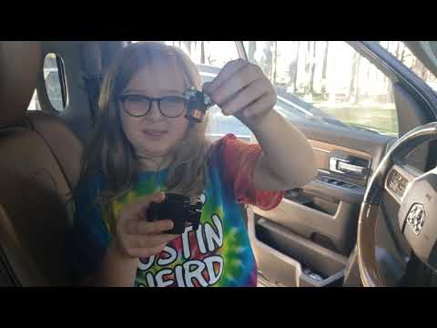

Have you considered disassembly and cleaning? I feel like I've seen something about the button itself being removable and there is the lower trim key whole underneath. Might be worth looking into...
Edit: Here you go, she's young but she has good instruction (just don't use WD40 but something like QD Electronics Cleaner).

Saw that this morning. I think the little contact behind the button might be flattened and it is only a matter of time before I get stranded I'm afraid. Thank you
