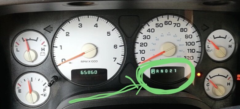

Since the motor shuts off so fast upon starting it, I can’t tell if your check engine light is staying on purposely to indicate a fault, or if the motor is just shutting off too quick before the computer has a chance to get done with the initial sequence of the check engine light. What I mean by that is, if you’ve noticed every time you start your truck, the check engine light stays on for a little bit after you start it and if everything checks out, it’ll go out or it’ll stay on if there’s a fault so, if there’s no one around with a code reader to retrieve stored codes if there are any, you can do what they call the “key dance” on those trucks to check for codes that will read out where I have the green circle in the bottom pic. If there aren’t any codes, you’ll see a series of dashes in that display along with the word “done” but if there are stored codes, it’ll be a 4-digit number that begins with a “P”. 37e8bb791935006f92dcb218728e6c89.jpg
Starting with the key in the ignition, turn the key to the on(but not start) position, then back to the completely off position(the one where the cylinder will let you take the key out). Do this two or three more times fairly fast ending with the on but not start and if you did it right, and if there are codes, they will display in the screen below your PNRD12.
