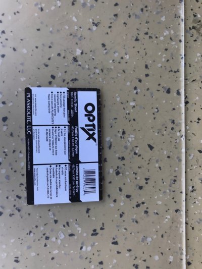

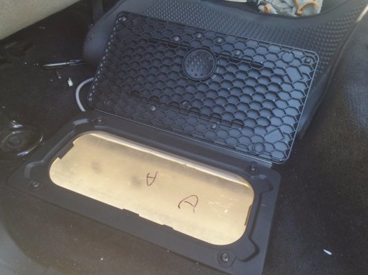

Thanks everybody for the suggestions, i took a little bit of everyone ideas and here is what i did with a .22" plexiglas sheet and weather stripping, totally reversible.
40237564413_82356cbff7_h.jpgUntitled by RAM RSM, on Flickr
40237552883_01cf942887_h.jpg2019-02-24_04-14-18 by RAM RSM, on Flickr
33326927188_ff7a7b7152_h.jpg2019-02-24_04-14-33 by RAM RSM, on Flickr
40237555883_98b499c04d_h.jpg2019-02-24_04-14-50 by RAM RSM, on Flickr
I ended up shaving the ears on the covers, will still work without them if i decided to put the bins/holders back.
46287884855_1c66d89626_h.jpg2019-02-24_04-14-59 by
RAM RSM, on Flickr
And i also had to remove the locks, they're held by 2 screws
47150540852_3e99321b70_h.jpg2019-02-24_04-15-17 by RAM RSM, on Flickr
40237560063_be32747acd_h.jpg2019-02-24_04-15-26 by RAM RSM, on Flickr
The mat will cover the covers and that's it for now,Will see how that plastic sheet will hold up.
