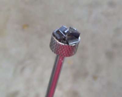

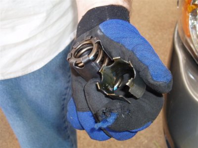

Found something interesting in the oil pan, back about a year and a half ago I had a 6.1 spring fail. The feet broke off the damper and the damper was banging against the valvecover. I always wondered what happened to the feet, well during the shortblock install I found them in the pan.

Damn that's pretty crazy. At least you found them. That coulda messed some **** up good huh?
Once they hit the pan I was safe, I just would have thought they flowed out with an oil change. I thoroughly checked the heads for those feet when I replaced the spring, so I assumed/hoped they just went down the oil return holes to the pan. The damper has 6 feet and I found 5....wonder where that last one got to?

Sam thats odd didnt know the 6.1s had any failure issues of any sort.
