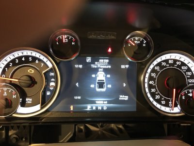

Got mine today and did a test install to make sure everything works!!! I have a 2014 Big Horn and the TPMS reads correctly on the 2016 cluster. Now just just need to wait about 1000 miles til i hit the mileage on the new cluster.
Now I've got to wait til this Saturday for my new 2016 8.4" RA4 radio to arrive!!!

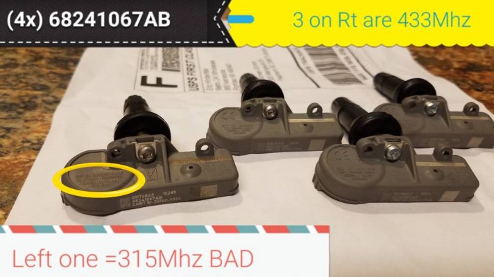

Well here's a bit of interesting tpms info that might relate to the reason why the evic tpms compatibility changes around 2014/2015 (can't recall which year exactly).
When trying to order extra tpms sensors for my 2013 truck here's what I found..
Ref. Ram Body Builder site: www.rambodybuilder.com
- 2013 tire & wheel info
http://www.rambodybuilder.com/2013/docs/intro/twlnwv.pdf
** My 2013 ram 1500 uses:
433(.92)Mhz sensors
PN: 56029398Ax (superceded by 68241067AB)
** 2013 Tpms module: 56029542Ax
(433.92 Mhz by Schrader​ Electronics)
Located near left front foglight on backside of bumper.
I received 4x of the correct Mopar PN sensors, but 3x are 433Mhz and 1x is 315Mhz. So it seems like there was a transition to 315Mhz during the 2014 M.Y.
Anyone care to confirm the Tpms sensors PN & frequency on their 2014-2016 trucks? I'm under the impression that the 2014/2015 & up Tpms module in the trucks are made by TRW vs Schrader (2013 & older).

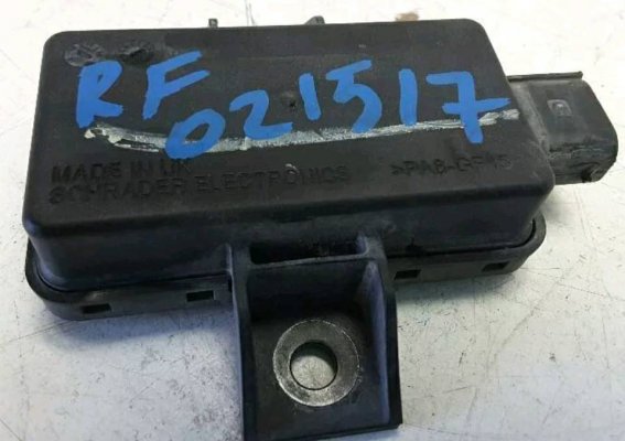

My guess is to go look at the module that's installed on the truck. Here's a picture of the same pn (2013 w/433Mhz) that I have from eBay...
Also, the Ram Body Builder site listed the same pn and frequency of tpms Sensors on their site/pdf

Where's the module located on the vehicle Sir ?
Sent from my SM-G900V using Tapatalk
Mpgrimm2
Supporting Vendor Navy Badge
Mar 30, 2014
6,572
5,168
SC
2022 Ram 1500 (5th Gen)
5.7L
Back of bumper, lower left side
