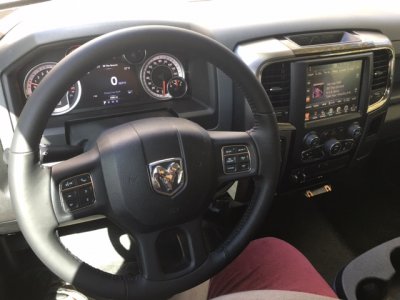

I love mine, best mod I ever did next to my 8.4 radio. Thanks to M2mods and Don for all the help, could not have done it without you guys.
