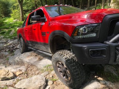

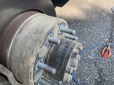

I have bora spacers on my Power Wagon to help with fitment of my 37’s. Did basically everything in the video, including trimming down my lugs. I put painters tape on each wheel to use as my guide since I got 1” spacers and painters tape is 1”, that way I was guaranteed all lugs were the same length when I was done. Came out flawlessly and I have no regrets.
