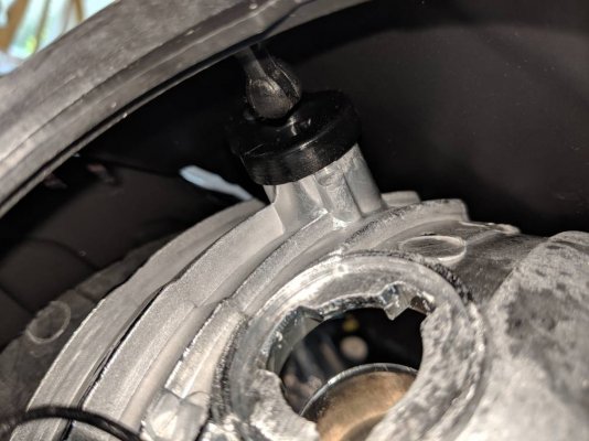

I had the same problem with aftermarket headlights and after a lot of frustration I finally found that the adjustment had come apart inside and it wasn't doing anything to adjust the screws. Yours may or may not be having the same problem but it's something to check...
(That ball joint is supposed to be connected to the socket)

Post a picture of the headlights you bought so we can get a better idea of the internals and adjustment parts.

Check your adjustment washer on the underside of the vertical mounting screw(silver looking nut/washer the bolt screws into). If not held in place when removing the headlights, it will spin and dewwacky your vertical as well. Adjust it, and I bet you have to lower the internal adjustment back to a lower position.
