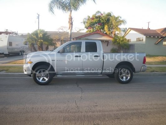

As you can see in this pic that it looks like I'm nose high. However, the rear has about 3/4" more travel to the wheel than the front.

I haven't had a chance to measure mine yet but maybe mine is the same. However I'm more concerned with the vibration now then I am about it being nose high. So I may end up taking it back apart still anyhow. But thanks.
