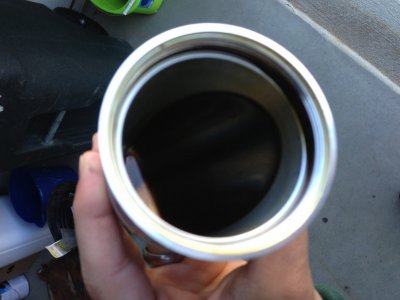

i was never a fan of a catch can. Run a clear hose from the side going back to the intake and you will still see a ton of oil! Kind of defeats the purpose to have something when you're still letting oil back in. A air/oil separator is what you want and need! Only way to be 100% sure. I made my own from a copy of someone else's (name left out). Here you get the idea from them...they cost almost $400 yet I only have about $12 in each.
Blow by/oil enters the side port to the left/middle of the AOS in the pic.
It then collects and drains out the bottom. Some cars have a drain back to the oil pan so these are 100% maintance free! Never need dumping.
The "baffle" you can see that oil would have to make its way up into the inner can and then somehow get sucked up into the "hanging in mid air tube", which is impossible. The inner can also has a drain hole to dump whatever makes its way in, plus for condensation that always builds up because its a metal can going through temp changes.
