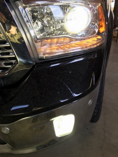

Just got my plus canbus kit for my fogs after returning the cheaper kit. It works! I used same kit as my lows ddm plus canbus 35w-9006 4500k 92da308dcec36ed63fbbd60c41afaaf6.jpgf1033d7ddac9d74a11a328858dd54318.jpg7050417975f888c9bde8d2759be2016f.jpg

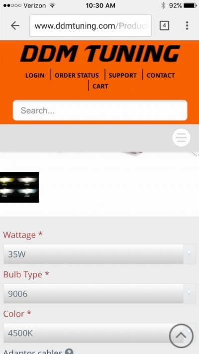

Could you tell me part numbers and where you ordered for your projectors and fogs?

Go to ddm tuning .com. It's the plus canbus kit.d80bd28d0d94a0be9f6cd937ab519645.jpg94eb171634e4b64e7fdf3c0c876406b0.jpg

Sorry i didn't take pics when I did it and my truck is at the dealer putting a factory trailer brake on it because myn didn't come with it. so i will try to get some when it comes back later today. I mounted my ballasts on a angular plastic piece that connects to the fog light housing. I just took some self taping screws and bolted the ballast to that angular piece. All that plastic piece was was a brace so it did not hert it to drill into it.
