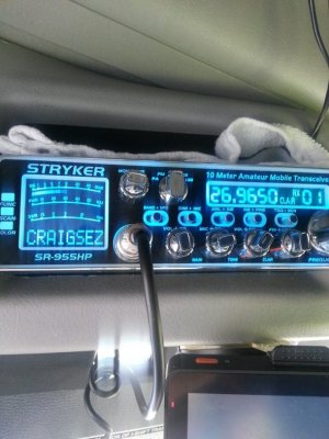

your kelvin rateing(bulb color)will also differ some to if you use 55 watt over 35 watt..Only as an example....35 watt with say a 5000 k(looks bluer) will be like a 6500 k with a 55 watt(really white)..
Luv the ddm stuff..Got them on my zx10 and in my freightliner,only bad is that i get alot of static comming through my stryker 955 radio
