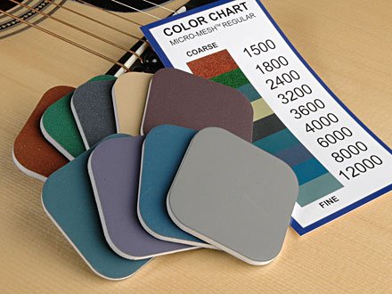

Thanks for the reply would you use the Kit for headlights?
I have not tried the kit. I use this stuff on hand made pens. I do make one that is clear acrylic and when I go through the grits there are no scratches left. It is a LONG process with a lot of water. I generally soak all the pads in a bucket and work them until they dry out, then move to the next grit. I know this stuff was designed for airplane canopies so it should work.
