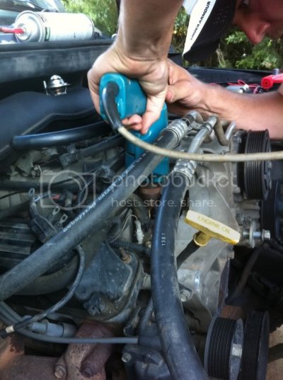

I tried to drill it out like I've done before, but for some reason I couldn't drill any deeper than around 1/16th in. Its the top left bolt

I feel your pain...
Had the exact same thing happen with mine. I ended up having to put a heli-coil in there and get a shorter bolt for that side

Bottle of anti-seize works better...
As for getting the stud out you might try a bit of BP blaster and heat... Then using a small punch might get it to move...
