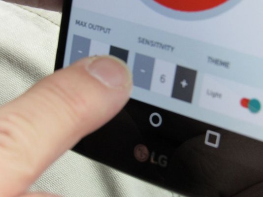

I wouldn't want to have to reach for my phone if I need to use the manual brake lever on the brake controller while driving.

That's pretty interesting. I'm not sure the cost, the link doesn't work. But, I always adjusted the brake before getting going, so I think that you wouldn't need to use your phone anymore after setting it up.

don't try to use the hands free mode with this device as soon as you hit the brakes it cuts the call off, going with the oem as soon as i can get time , pray for me and my mopar ! THE KURT wireless worked rather well when pulling my 7200# camper smoothing stopping every time and as long as you have the app running its just like pushing the button on the dash !

As said, biggest issue for me is no emergency manual lever handy in case your trailer starts swaying. If that happens, will you have the ability to grab or reach your phone and figure out how to apply maximum trailer brakes while at the same time keep your rig straight and on the road?
I think it would be very difficult in my experience. Stuff happens fast. Give me an old school manual lever that I know where its ,located and can get to it quickly...but that's just me
