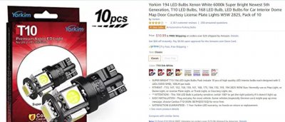

Well at least you got them switched out!! I found pulling it all apart was easier, but there are always 2 ways to do something!! Let me know if you get that part number!! Congrats!OK< Paulie, went over to a friends house and did Surgery on dat upper console. Since I had already pulled previously and broke the 2 front tabs by the eyeglass holder, not a problem. I DID not take apart all of the metal for the socket from the rear. Used small eyeglass screwdrivers and carefully pried off the lenses. Replaced with Led 10's, already did my floor lamps and replaced rear upper with festoon 42, or 44, not remember which one. Then put console back up. Since I broke those (2) tabs, used lock tight on the 2 screws and wala, installed with LED. What a PITA...

None yet. Work perfectly.Hi,
Just a quick question for anyone who has swapped out the interior bulbs to LED's. I read this in the manual (pg 408) "All of the inside bulbs are brass or glass-wedge base. Aluminum base bulbs are not approved". Just wondering if anyone has had any issues? Thank you.
