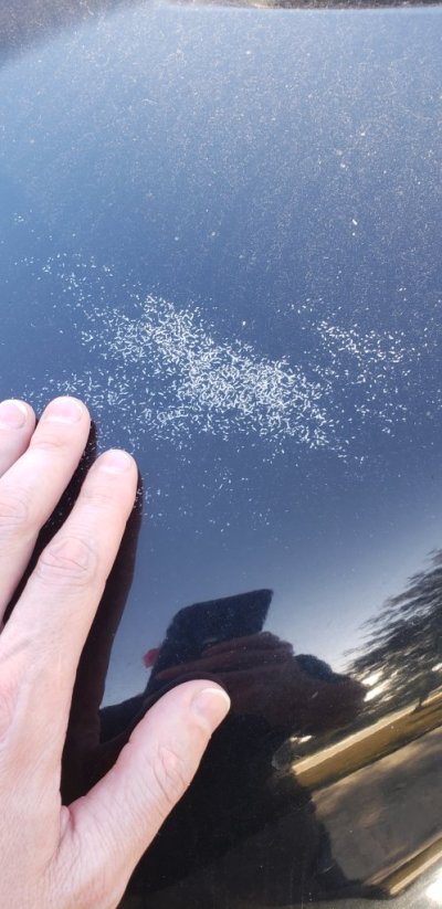

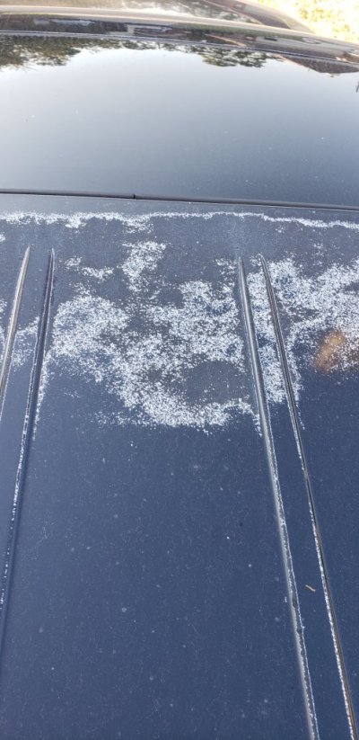

Is anyone else having these paint/clearcoat issues?

Happened on my Ford's roof in spots. The roof is the most neglected, abused in the hot Texas sun, many times the lightest area the clear coat is applied, ect. This been happening on trucks for decades. And some cars too.
Good news is it's an easy mask, sand, and re-shoot.

This has never happened on any of my other trucks. Ever!?! It is on the roof, the hood and even the bumper?? I can't be the only 10 year old Ram truck in Texas that this has happened

Don't misconstrue. Yes, It does happen. But doesn't mean it will to all trucks.
When looking, it may start out as little bubbles. My ford had it on the roof edges of the ribs and a touch of it on the rear most roof cab corners. Hood was fine.
My Dakota it was similar on the roof and majority of the clear and some paint had just disappeared from the hood. The sides it actually peeled and clouded from bubbling. Definitely a poor factory paint job.
I'll have to check my Ram now next time the Tonneau cover is rolled up, but I wouldn't be surprised if I see little bubbles.

Looks like typical UV degradation. Is that truck blue? Blue can be the worst for UV absorption. You may want to take it to a detailer that has a hand held microscope or buy one yourself. You want to determine which layer of paint it has penetrated to which will determine the extent of the repair. You can buy Universal 60X Clip-on LED Cellphone or hand held LED 60 to 75X LED Zoom Microscope for not much money online. Good luck.

It's black and it sits in my driveway with zero shade. The last couple of summers have been dry and hot. You can't even keep your hand on the hood for more than a second without getting a blistering burn.

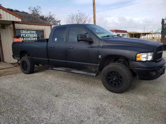

Yep, same situation, kept getting white spots under top coat. Got mad and had the truck totally painted FLAT BLACK MATT. they even painted the chrome bumpers and anything else that was chome. came out great. no more waxing.

Paint on my '10 is still good and shiny,hard tonneau is showing signs like yours tho..im gonna have to mess with that here pretty soon.
I've seen people down here completely spray the whole truck with bedliner stuff...jeeps especially.
That's prolly the end all answer to everything.
